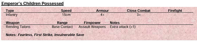

Emperor’s Children Land Raider
As Chaos Land Raiders with the Fearless ability. May transport one Emperor’s Children Chosen unit, or two of the following units: Emperor’s Children Noise Marines, Emperor’s Children Havocs, Emperor’s Children Possessed.
Emperor’s Children Rhino
As Chaos Rhino with the Fearless ability. May transport two of the following units: Emperor’s Children Noise Marines, Emperor’s Children Havocs, Emperor’s Children Possessed.

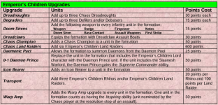

EC3.0 Emperor’s Children Chaos Space Marine Army List
EC3.1 Using the Army List
Emperor’s Children Marines are organised around core formations called companies or retinues which are supported by smaller formations of specialised troops. Each formation is made up of four or more units, and may also include a number of extra units called upgrades. The chart below shows the company, support formations, what units comprise the detachment, what upgrades are allowed, and its points cost. Each upgrade that is taken adds to the cost of the company or detachment, as shown on the upgrade chart. The upgrade chart also lists the units that make up the upgrade. Note that these will sometimes replace units in the detachment they are taking for, and sometimes take the form of additional units for the detachment. Each upgrade may be taken once per formation.
Emperor’s Children armies may be supported by Slaanesh Titans, Chaos Navy and Spacecraft. Up to a third of the points available to the army may be spent on these formations.
